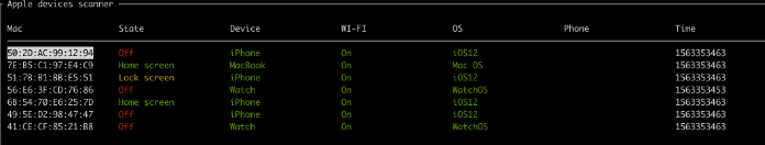

As a result, you can create a simple BLE packet analyzer:

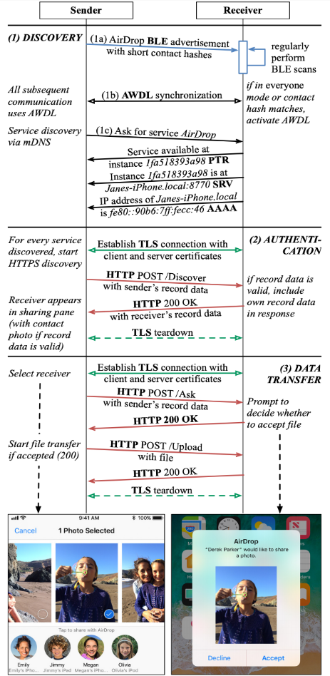

AirDrop
This technology allows you to exchange files between Apple devices without an Internet connection. On every share, the device sends your phone hash in SHA256. Thus, having created a database of phone numbers (hash: phone number), you can do quite efficiently catching phones in crowded places ... and send personalized messages to their owners via iMessage (the owner's name can be obtained via TrueCaller or from the device name). The profit for the stores is more than obvious: sending spam to everyone passing by.Getting Wi-Fi passwords

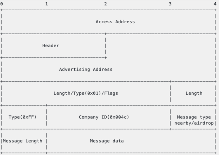

BLE packet analysis
By modifying the scripts from the py-bluetooth-utils package, you can view the BLE traffic sniffer. Apple uses ADV_IND messages to send device status.Advertise package structure
Nearby messages
Example of message types:0x05 — Airdrop

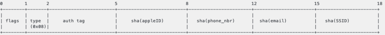

Wi-Fi
When trying to connect to Wi-Fi from device A, a packet of the following structure is sent, containing the first three bytes from SHA256 hashes AppleID (5-7 bytes), phone number (8-11 bytes), email (12-14 bytes):Presumably, Apple devices hash all contacts and compare them with those received in the advertise packet. When device B receives a packet with matching contact hashes, device B will offer the network connection password to device A.
If you generate a table of hashes of phone numbers for a specific region (about several million), then for the first 3 bytes of the hash, you can get a collision of the order of several tens of numbers per hash. There are two ways to check the correctness of the numbers:
- Some of the numbers can be excluded by checking them through the HLR ( HLR Lookup - Front Page - Index ).
- Since the number must be tied to the AppleID, you can check it through iMessage.
AirDrop
Apple AirDrop has three privacy settings:- Receiving Off.
- Contacts Only.
- Everyone
In this case, AirDrop is used only to initiate the transfer, for the very same data transfer, a peer2peer connection via Wi-Fi (AWDL - Apple Wireless Direct Link) is used.
During authentication, the sender sends sender's record data credentials to verify the recipient's privacy settings. This message contains the complete SHA256 hash of the sender. Thus, an attacker can respond to all other people's AirDrop BLE requests, receiving full hashes of numbers.
How AirDrop works:
