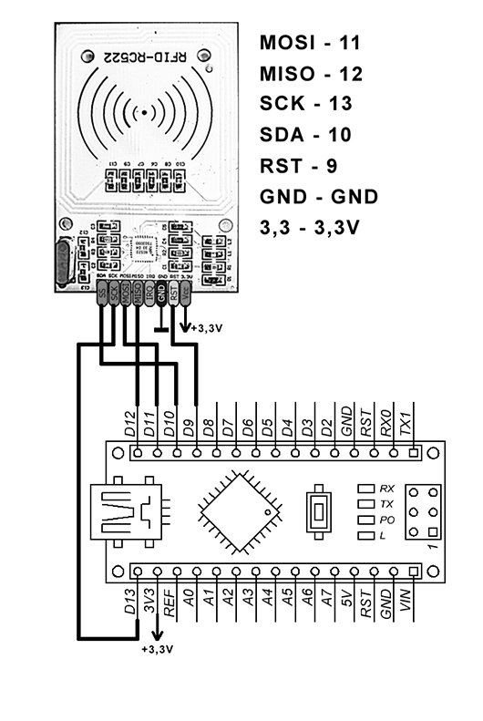

First, let's see how to connect the RC522 reader module to the Arduino. For those who watched the previous lesson and were not too lazy to collect their castle, congratulations. Write down who built the lock.
I will not explain the scheme, and so everything is clear. If something is not clear, write in the comments.

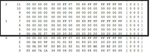

First, let's look at the card dump. To do this, load dumpinfo from the sketch.
We attach the card to the reader and wait until all data is counted.
We are interested in sectors 1 and 2.
The null block stores service information. This information is not rewritable and is flashed by the manufacturer. At least on the cards that come with the module. There are crds where this information can also be overwritten.
The first 4 bytes contain the serial number of the card, and the remaining bytes contain information about the manufacturer.
The first block now contains zeros, which means that there is no information there. It is also missing in the second and fourth blocks. We will use these blocks to record and store our information.

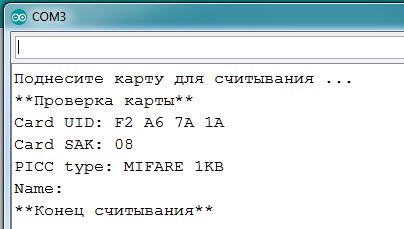

First, run Example 1.
We are asked to bring the card for reading.
Well, let's do that.
We'll wait until it's over.
What we see here, or rather, only I will see, since you still have a blank card and you will not see anything, well, except for the CARD NUMBER.

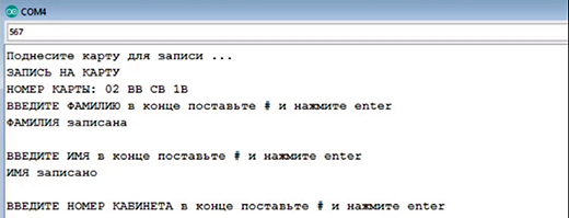

Uploading sketch Example 2.
write to the card
Bring up the card.
By the way, there is a limit on the waiting time for text input. I set 60 seconds.
First, enter your LAST NAME and the "grid" symbol. This symbol indicates that the input is finished and the text needs to be processed. Press ENTER.
Then enter the NAME and enter the grid again and press ENTER.
Now enter the cabinet number, grid, and ENTER.
And if after each input you had no errors and you see the inscription REMOVE THE CARD, then everything went well, and now you can go to EXAMPLE 1 and read your entries from the card.
write to the card
Bring up the card.
