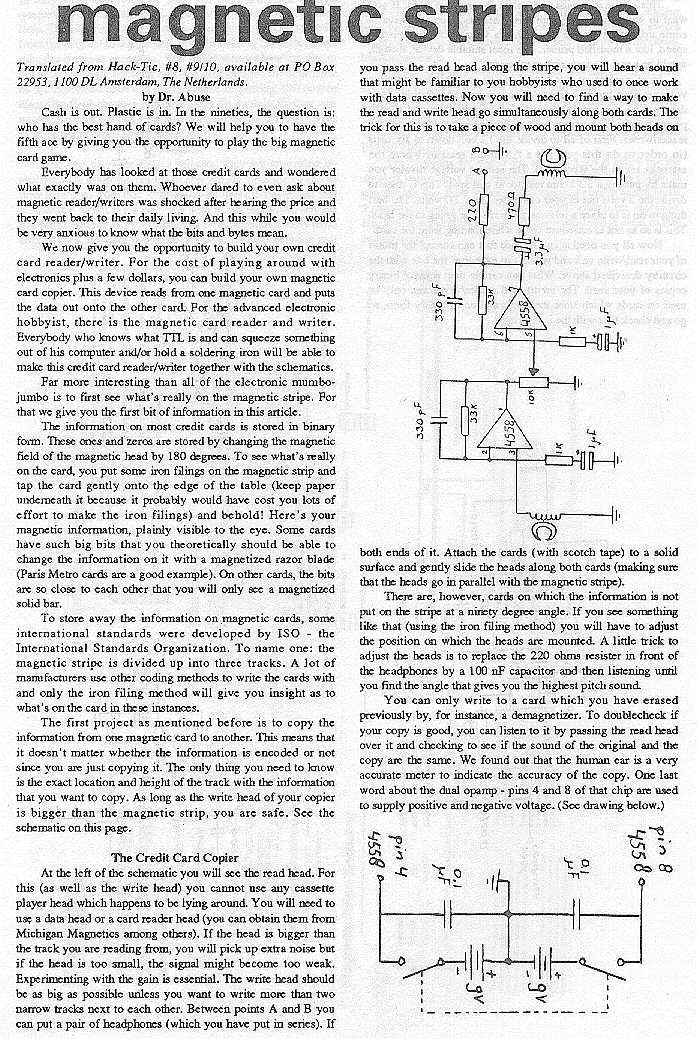

The Credit Card Copier
At the left of schematic #1 you will see the read head. For this
(as well as the write head) you cannot use any cassette player head
which happens to be lying around. You will need to use a data head
or a card reader head (you can obtain them from Michigan Magnetics
among others). If the head is bigger than the track you are reading
from, you will pick up extra noise but if the head is too small, the
signal might become too weak. Experimenting with the gain is
essential. The write head should be as big as possible unless you
want to write more than two narrow tracks next to each other.
Between points A and B you can jput a pair of headphones (which you
have put in series). If you pass the read head along the stripe,
you will hear a sound that might be familiar to you hobbyists who
used to once work with data cassettes. Now you will need to find a
way to make the read and write head go simultaneously along both
cards. The trick for this is to take a piece of wood and mount both
heads on both ends of it. Attach the cards (with scotch tape) to a
solid surface and gently slide the heads along both cards (making
sure that the heads go in parallel with the magnetic stripe).
There are, however, cards on which the infomation is not put on
the stripe at a nintey degree angle. If you see something like that
(using the iron filing method) you will have to adjust the position
on which the heads are mounted. A little trick to adjust the heads
is to replace the 220 ohms resister in front of the headphones by a
100 nF capacitor and then listening until you find the angle that
gives you the highest pitch sound.
You can only write to a card which you have erase previously by,
for instance, a demagnetizer. To doublecheck if your copy is good,
you can listen to it by passing the read head over it and checking
to see if the sound of the original and the copy are the same. We
found ou that the human ear is a very accurate meter to indicate the
accuracy of the copy. One last word about the dual opamp - pins 4
and 8 of that chip are used to supply positive and negative voltage
(see schematic #3).

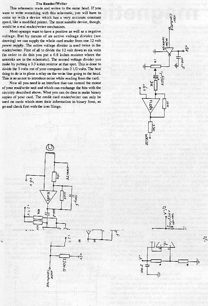

The Reader/Writer
This schematic reads and writes to the same head. If you want to
write something with this schematic, you will have to come up with a
device which has a very accurate constant speed, like a modified
printer. The most suitable device, though, would be a real
reader/writer mechanism.
Most opamps want to have a positive as well as a negative
voltage. But by means of an active voltage divider (see schematics)
we can supply the whole card reader from one 12 volt power supply.
The active voltage dicider is used twice in the reader/writer.
First of all to divide the 12 volt down to 6 volts (in order to do
this you put a 5.8 kohm resistor where the asterisks are in the
schematic). The second voltage divider you make by putting a 3.3
kohm at that spot. This is done to divide the 5 volts out of your
computer into 2.5 volts. The best thing to do is to plave a relay
on the write line going to the head. This is so as not to introduce
noise while reading form the card.
Now all you need is an interface that can control the motor fo
your read/write unit and which can exchange the bits with the
circuitry described above. What you can do then is make binary
copies of your card. The credit card reader/writer can only be used
on cards which store their information in binary form, so go and
check first with iron filings.

strip, you are safe. See the schematic on this page. (Schematic #1)
(see schematic #3).
The Reader/Writer
In this section, we will describe several data formats which are
used in credit cards. We will only describe the three tracks as
they were described by ISO. On the third track a large quantity of
formats are used. Only two of them are published here. The real
formats as they are used by banks tend to differ from the original
ISO standards but a little bit of research can do miracles on these
occasions. You might wonder how the bits as described later are
encoded onto the card because the schematic as we described above is
only capable of putting 180 degree magnetic field changes onto the
card. To explain that we use track 2 because the bits are
physically the largest and this ought to work with homemade
electronics.
