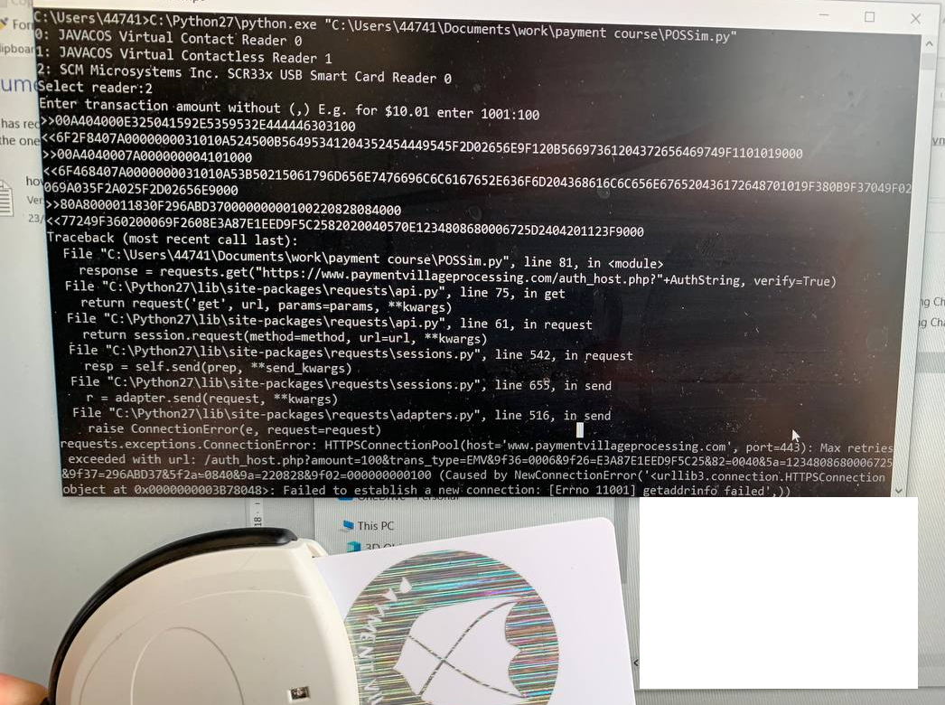

POSSim.py
Python:
from smartcard.System import readers
from smartcard.util import toHexString
import random
from datetime import date
import requests
r_list=readers()
i = 0
for r in r_list:
print str(i)+": "+str(r)
i = i+1
id = input("Select reader:")
connection = r_list[int(id)].createConnection()
connection.connect()
amount = input("Enter transaction amount without (,) E.g. for $10.01 enter 1001:")
if (amount>1000):
exit("Price cannot be more than $10 as we do not accept PIN (yet).")
def APDU(cmd):
res = ""
for i in cmd:
res = res + "%0.2X" % i
print ">>"+res
data, sw1, sw2 = connection.transmit( cmd )
res = ""
#print "%x %x" % (sw1, sw2)
for i in data:
res = res + "%0.2X" % sw1+ "%0.2X" %sw2
print "<<"+res
return res
SELECT = [0x00, 0xA4, 0x04, 0x00, 0x0E, 0x32, 0x50, 0x41, 0x59, 0x2E, 0x53, 0x59, 0x53, 0x2E, 0x44, 0x44, 0x46, 0x30, 0x31, 0x00]
APDU(SELECT)
SELECT = [0x00, 0xA4, 0x04, 0x00, 0x07, 0xA0, 0x00, 0x00, 0x00, 0x04, 0x10, 0x10, 0x00]
APDU(SELECT)
#80 A8 00 00 11 83 0F 70 55 81 F9 00 00 00 00 01 00 22 08 03 08 40 00
#9F 37 04 -- Unpredictable Number
#9F 02 06 -- Amount, Authorised (Numeric)
#9A 03 -- Transaction Date
#5F 2A 02 -- Transaction Currency Code
today = date.today()
UN = []
UN_str = ""
for i in range (0,4):
rand = random.randrange(0,255)
UN.append(rand)
UN_str = UN_str + "%0.2X" % rand
amount_full = str(amount).rjust(12,'0')
amount_list = []
for i in range(0,6):
amount_list.append(int(amount_full[i*2:(i*2+2)],16))
GENERATE_AC = [0x80, 0xA8, 0x00, 0x00, 0x11, 0x83, 0x0F] + UN + amount_list
GENERATE_AC.append(int(today.strftime("%y"),16))
GENERATE_AC.append(int(today.strftime("%m"),16))
GENERATE_AC.append(int(today.strftime("%d"),16))
GENERATE_AC = GENERATE_AC + [0x08, 0x40] # Currency - USD
GENERATE_AC = GENERATE_AC + [0x00] # end byte
Response = APDU(GENERATE_AC)
ATC = Response[Response.find("9F3602", 0)+6:Response.find("9F3602", 0)+10]
ARQC = Response[Response.find("9F2608", 0)+6:Response.find("9F2608", 0)+22]
PAN = Response[Response.find("570E", 0)+4:Response.find("570E", 0)+20]
AIP = Response[Response.find("8202", 0)+4:Response.find("8202", 0)+8]
AuthString = "amount="+str(amount)+"&trans_type=EMV&9f36="+ATC+"&9f26="+ARQC+"&82="+AIP+"&5a="+PAN+"&9f37="+UN_str+"&5f2a=0840"+"&9a="+today.strftime("%y%m%d")+"&9f02="+amount_full
#print AuthString
#print "https://www.paymentvillageprocessing.com/auth_host.php?"+AuthString
response = requests.get("https://www.paymentvillageprocessing.com/auth_host.php?"+AuthString, verify=True)
print "======================================="
print response.content.replace("<br>", "\r\n")
Этот код будет работать с любой из наших кредитных карт Paymentvillage.Org, если у вас есть подходящие считыватели, например SC3310.

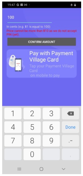

Задача 1. Обойти ограничение в 10 долларов для бесконтактных платежей.
Лимит бесконтактной оплаты устанавливается в приложении:
SMALI code
if-le v0, v1, :cond_2
invoke-virtual {p0, v2}, Lcom/peerbits/nfccardread/NfcHome;->findViewById(I)Landroid/view/View;
move-result-object v0
check-cast v0, Landroid/widget/TextView;
const-string v1, "100"
invoke-virtual {p1, v1}, Landroid/widget/EditText;->setText(Ljava/lang/CharSequence;)V
const/16 p1, 0x64
iput p1, p0, Lcom/peerbits/nfccardread/NfcHome;->amount:I
const-string p1, "Price cannot be more than $10 as we do not accept PIN (yet)."
invoke-virtual {v0, p1}, Landroid/widget/TextView;->setText(Ljava/lang/CharSequence;)V
goto :goto_0

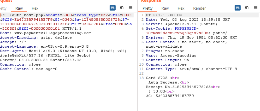

Перестройка приложения и изменение лимитов было бы самым простым решением. Но у нас также есть прямой доступ к потоку транзакций, поэтому давайте попробуем его использовать. Как выглядит запрос на авторизацию транзакции для платежа в размере 1$?
GET /auth_host.php?amount=100&trans_type=EMV&9f36=0041&9f26=A2DC5F69F987B086&82=0040&5a=1234808680006725&57=1234808680006725D2404201123F&9f37=705581F9&5f2a=0840&9a=220803&9f02=000000000100 HTTP/1.1
Host: www.paymentvillageprocessing.com
Сразу бросается в глаза тот факт, что сумма транзакции появляется в запросе дважды: первый — параметр суммы, указывающий, сколько продавец взимает с покупателя. Второй — поле суммы EMV (9f02), используемое для генерации криптограммы:
Для успешной генерации криптограммы нашей карте требуются сумма и валюта от SoftPOS.
В прошлом году мы показали, что такие платежные гиганты, как Visa, MasterCard и AMEX, позволяют авторизовать транзакции, в которых поля сумм различаются.
Например, я могу запросить криптограмму на сумму 1,01$, но я буду использовать ее для списания с карты суммы в 50$:
https://www.paymentvillageprocessing.com/auth_host.php?amount=5000&trans_type=EMV&9f36=0043&9f26=EA423B5F9415B7F9&82=0040&5a=1234808680006725&57=1234808680006725D2404201123F&9f37=92D667DA&5f2a=0840&9a=220803&9f02=000000000101
Почему это возможно? Короткий ответ — «наследие». EMV не существовало пятьдесят лет назад, и запрос на авторизацию транзакции с магнитной полосой выглядел примерно так:
Позже, когда поток EMV был интегрирован в существующие платежные схемы, Visa и MasterCard создали "Поле 55" - поле, в котором будут храниться все теги EMV. В нашей платежной схеме Поле 55 было заменено девятью параметрами EMV, отправленными отдельно:
9f36 (Счетчик транзакций приложения), 9f26 (Криптограмма транзакции), 82 (AIP), 5a (PAN), 57 (Эквивалент Track2), 9f37 (UN), 5f2a (Валюта транзакции), 9a (Дата), 9f02 (Сумма). Таким образом, в запросе авторизации у нас получилось два поля цены.
Правильным решением здесь было бы проверить согласованность между двумя полями «Сумма», если происходят операции EMV/NFC, но этого никто не делает.
Пять лет назад мы обнаружили ту же уязвимость в реализации Apple Pay, когда авторизованная сумма могла отличаться от списанной суммы (https://www.blackhat.com/docs/us-17...Future-Of-Applepwn-How-To-Save-Your-Money.pdf)
Из-за неоднозначности поля «Сумма» в спецификации платежа существует возможность злоупотребления транспортными или транзитными схемами Apple, Google и Samsung Pay и совершения мошенничества.
В итоге наша уязвимая платежная система, такая как Visa или MasterCard, будет взимать с вас цену, указанную в поле суммы, даже если представленная криптограмма разрешает совершенно другую цену.
Эту задачу решили четыре человека.

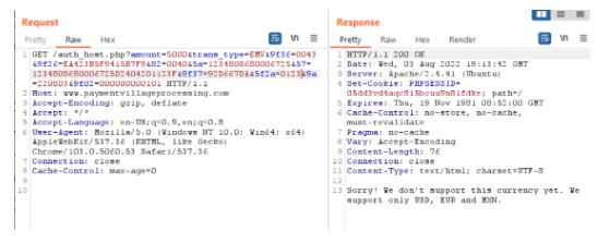

Задание 2. Используя одну карту, совершите платежи на общую сумму, эквивалентную 500$.
Шаг 1. После снятия первых 100$ обработка ответа с полезной ошибкой "Карта **** Недостаточно денег!". Преступники могут использовать это для атак по проверке баланса.
Шаг 2. На счете USD больше нет денег, но наша платежная система поддерживает несколько валют; в противном случае не было бы необходимости в поле 5f2a EMV (валюта транзакции). Помимо EMV, мы используем коды валют ISO-4217. А что если мы поместим туда случайную валюту:
Вот ценная информация - платежная система поддерживает три валюты:
Доллары США - 0840
Евро - 0978
MXN - 0484
А если мы изменим валюту с USD на EUR, транзакция будет авторизована!
Подождите, как это возможно? Должна ли валюта быть частью криптограммы? Поскольку карта запрашивает поле валюты в списке PDOL, это не значит, что это поле является одним из входных данных для криптограммы. Мы обнаружили это в 2017 году, когда взломали самую популярную версию бесконтактной криптограммы Visa, CVN17. Оказалось, что многие поля, запрашиваемые картами Visa, используются только для этапов управления рисками на карте и не будут проверяться во время авторизации транзакции.
Но если мы попытаемся сгенерировать криптограмму для другого платежа в EUR, мы получим ошибку «Извините! Эта карта не поддерживает более одной транзакции в месяц!». Что с этим делать? Давайте попробуем печально известную атаку с повторным воспроизведением криптограммы. Напомню, что криптограмма всегда имеет две переменные, изменяющиеся при каждой транзакции: ATC — последовательный счетчик транзакций и UN — случайные 4 байта, генерируемые терминалом. Но что, если ATC, UN и все остальные поля одинаковы? Это означает, что криптограмма действительна! Это означает, что точно такая же криптограмма может быть использована для авторизации более чем одной транзакции. Многие банки по-прежнему не проверяют ATC на предмет неисправностей и допускают атаки с повторным воспроизведением криптограммы, но мы видим доказательства того, что некоторые банки извлекли урок и изменили свои правила, чтобы противодействовать атакам с повторным воспроизведением.
С помощью атаки с повторным воспроизведением криптограммы удалось слить с карты еще 200 евро.
Boringdreams удалось украсть 100 со счета EUR, используя оригинальную криптограмму USD.

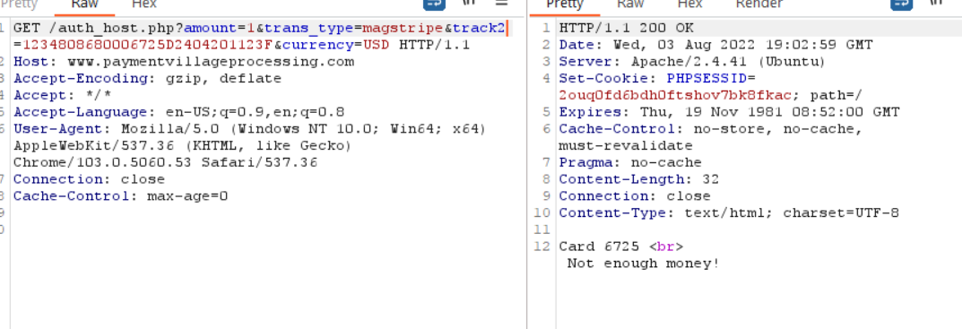

Шаг 3. При попытке совершить транзакцию в MXN вы получите еще одну информацию:
Извините! Эти карты не поддерживают EMV. Тип транзакции должен быть magstripe и параметры: track2, amount, currency.
Итак, это своего рода наследие — транзакции в мексиканских песо разрешены только с помощью карт с магнитной полосой. Транзакции с магнитной полосой не имеют функций безопасности, таких как криптограммы, поэтому вся информация, которую отправляет терминал, — это данные Track2. Но как мы можем получить данные track2, если на карте есть только EMV/NFC? Если вы прочтете наше последнее исследование о злоупотреблении Track2 Equivalent, станет очевидно, что некоторые банки будут принимать коды безопасности из данных EMV/NFC в транзакциях с магнитной полосой. Давайте прочитаем Track2 Equivalent с карты NFC и составим правильный запрос:

https://www.paymentvillageprocessing.com/auth_host.php?amount=10000&trans_type=magstripe&track2=1234808680006725D2404201123F¤cy=0484
Повторив этот запрос 41 раз, мы сможем списать еще 4100 мексиканских песо (~200$), что в общей сложности составит 500$, снятых с карты!
Пользователь Boringdreams попытался применить эту атаку, но безуспешно. Хотя это не помешало ему занять первое место в нашем испытании.
