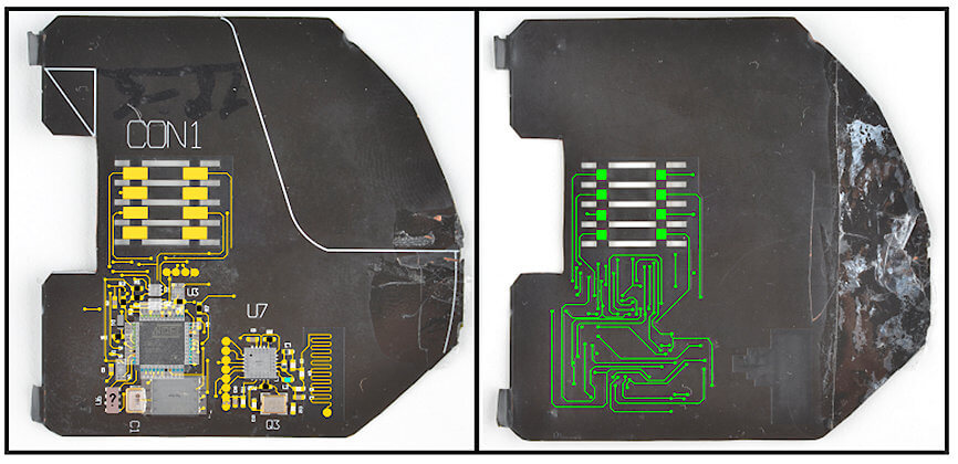

Shimmer - a device for discreet data removal when using chip cards at ATMs

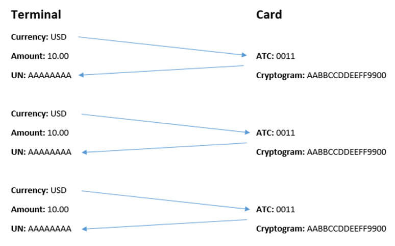

Cryptogram Replay. If the compromised terminal issues the same field UN, once read from the card, the cryptogram with the transmitted predictable field UNcan be used as many times as desired. Even the next day, attackers can transmit information about the old cryptogram with the old date in the authorization request, and this will not lead to denial. In my tests last year, I repeated the same cryptogram seven times over seven days, and this did not raise any suspicion from the bank.
Cryptogram Replay Attack Scheme

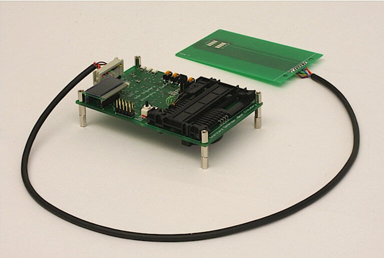

A device for the implementation of the "man in the middle" technique
