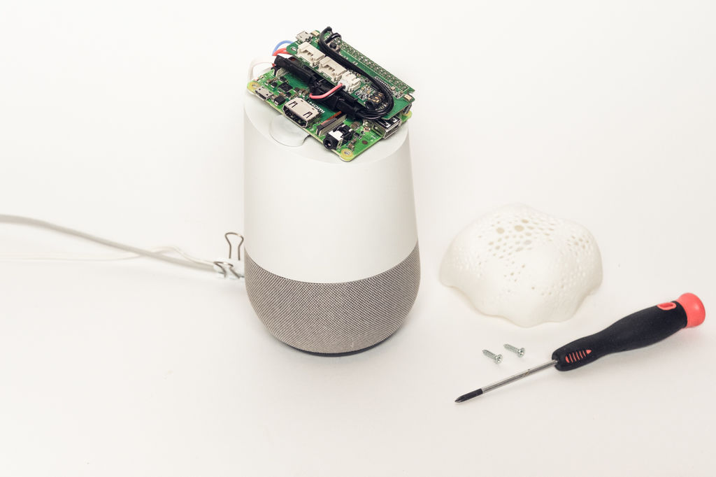

Project Alias is the technological equivalent of a parasitic fungus that lives on someone else's body. And this is a very useful "parasite" because it acts as a protector for its true owner, that is, a person. Alias blocks the transmission of information to Amazon and Google by drowning out the host microphones .
The assembly instructions are published on the Instructables website, and the program code is posted on Github .
To install you will need:
  • single board computer with Raspbian operating system, Raspberry Pi A + is enough;
  • ReSpeaker 2-Mics Pi HAT plug-in with microphones;
  • Tiny Speaker 16mm speakers;
  • Micro SD card, audio cable, wires and four screws;
  • access to a 3D printer to print the cover and holder.
The network-published 3D models for cover Home the Google (stl) and Echo Amazon's (stl), and a 3D-model of the speaker holder (stl).
The next step is building Alias. It includes connecting speakers to the ReSpeaker module and connecting 5V power to the Raspberry Pi (solder directly to the GPIO).

Then you need to train Alias to recognize your name, it can be arbitrary (any sound less than 2 s). The developers write that it is enough to write down the name on the phone 4-6 times and press the Train Alias button.
If desired, then the name can be changed.
And it's all. In the future, the Raspberry Pi performs speech recognition on its own, and the voice assistant no longer responds to the standard name (for example, Alexa) and does not send any data to the Google / Amazon cloud.
