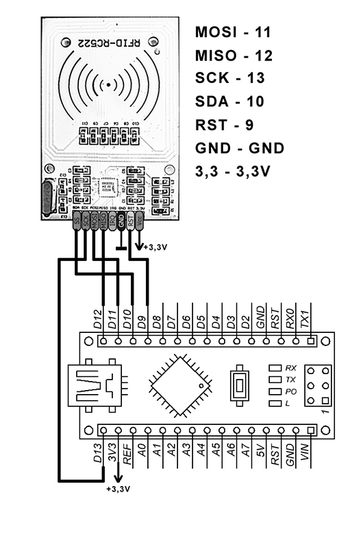

Today we will continue to study the RFID reader based on the RC522 chip.

I won't explain the connection scheme. I've been doing this for three lessons already. If something is not clear, write in the comments or watch previous lessons.

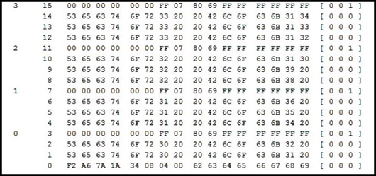

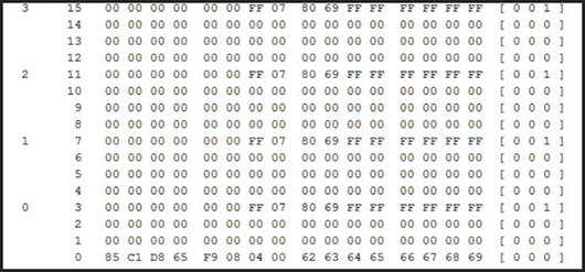

First, we'll load dumpinfo and look at the content of the cards.
We will consider sectors from 0 to 3.
Clean Card
Card with information

We check the cards. Let's see if there's any information there and we can erase it.
First, we look at the keychain.
It was clean and ready to be recorded.
If there was some information there and you don't feel sorry for it, then the next time you write it, it will be erased and a new one will be written on top of it.
We look at the same thing with card 1.
But card 2 contains the information we need. That's what we're going to copy.
