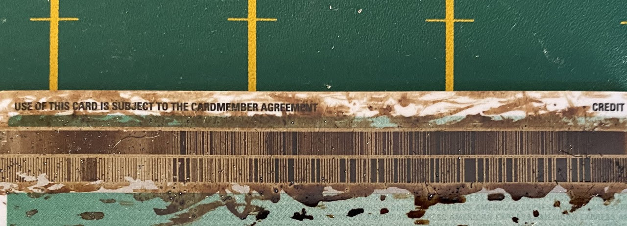

Magnetic stripe operations are one of the simplest methods. People associate it with certain types of fraud. Skimming at ATMs, double withdrawals at restaurants - all this is possible due to the disadvantages of the magnetic strip. The magnetic stripe is easy to copy - all you need is a dedicated magnetic stripe reader / encoder. Further, the cloned magnetic stripe is enough to pay in most supermarkets in the world. To verify the cardholder, it was supposed to use the signature on the check, which the cashier must verify with the signature on the back of the card.
In the picture above, you can see an example of the information recorded on the card. Black bars are ones, white bars are zeros. There are open source solutions for decoding this data - for example, magstripe.
In fact, you can see from the image that the card has not one, but two magnetic stripes of different densities (Track1 and Track2). What data does the magnetic stripe contain?
  • Card number, expiration date, cardholder's name - whatever is physically printed on the face of the card.
  • Service code - three digits that help the device interacting with the card (terminal or ATM) to understand what functions the card has and what does not. Can this card be used at an ATM, is the card equipped with a chip.
  • Verification code (CVV, CVC, CID - terminology depends on the payment system) - a code similar to the one written on the back of the card. It is calculated using the cryptographic check-sum algorithm (MDK MAC) using a 128-bit key from the information recorded on the magnetic stripe. Using a calculated CVV instead of a random one helps against attacks when, for example, an attacker replaces the service code and tries to convince the payment terminal that the card is not equipped with a chip. The issuing bank will receive the magnetic stripe data, verify it, and the checksum will not converge with the transmitted value in the CVV field. Verifications take place in a secure key store - the so-called HSM (hardware secure module).
