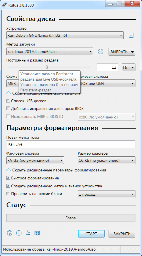

How do I make a bootable Kali USB stick with a Persistence partition?
To do this, you need to create two partitions on a USB Flash or SD card. One will be FAT32 for starting the OS - the image from kali.org is unpacked onto it. The second section is ext3 for saving settings, custom files and session changes.
Markup schema with Persistence section
Windows cannot handle flash drives with more than one partition and does not support ext3. However, in it such markup is simply done by the free utility Rufus. The main thing is to run the regular version (not portable).

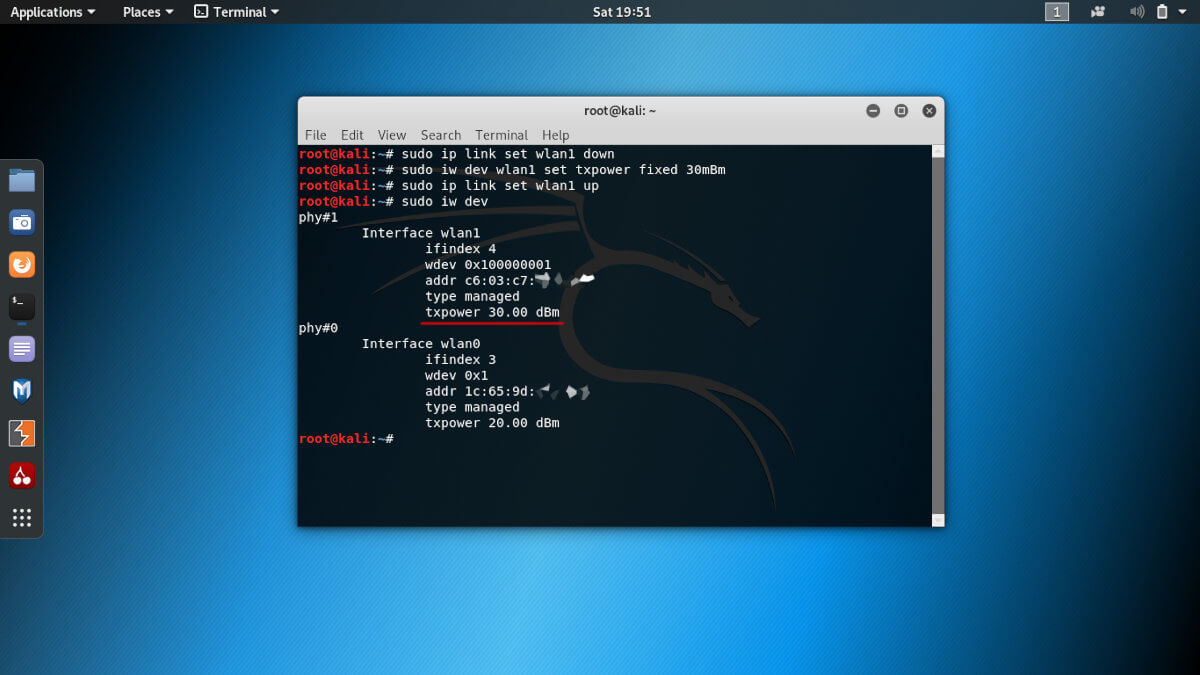

How to increase the power of the Wi-Fi adapter?
There are two methods to fire them up. The first is through the global settings in Kali. It is suitable for those adapters that read the region code from the OS.
Method 1
First, we look at the current parameters:
  • iw dev shows a list of wireless adapters and their maximum allowed power settings. Usually we see txpower 20.00 dBm (+20 decibels in relation to milliwatts), which in theory means a transmitter power of 100 mW, but in practice - that the attacked routers will most likely not hear your "whistle".
  • iw reg get displays the global WiFi usage restriction settings. In particular, ISO 3166-1 country code, available frequency bands and channel widths. If country 00 is specified, then the country is not specified and severe restrictions apply
Guyana (GY) and Belize (BZ) have the most liberal WiFi regulations, which allow ten times the power of WiFi adapters. The corresponding entry in the database looks like this: country BZ: DFS-JP. (2402 - 2482 @ 40), (30). (5735 - 5835 @ 80), (30). The DFS abbreviation after the country code stands for Dynamic Frequency Selection. It can be executed according to the American (FCC), European (ETSI) or Japanese (JP) scheme. You do not need to change it.
Further, the frequency window in the 2.4 and 5 GHz bands and the channel width in megahertz are indicated. How many channels you see depends on these parameters.

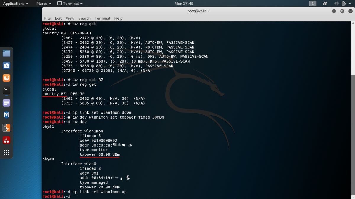

To change the region, just write in the terminal:
iw reg set BZ # Mentally transported to Belize with a laptop
ip link set wlan1 down # Disable external dongle designated as wlan1
iw dev wlan1 set txpower fixed 23 mBm # Double the transmitter power
The scale here is logarithmic, so a doubling of power (up to 200 mW) corresponds to a gain of 3 dBm (up to 23 dBm). Simply put, TxPower (dBm) = 10 * LOG (P / 1), where P is the power in milliwatts.
Changing the region and getting 1000 mW
Do not rush to immediately cut in the dongle to the fullest. There is a reasonable limit for each device, which is selected experimentally. One of my adapters is more stable at 27 dBm (500 mW) than at 30 dBm (1000 mW), and the other is generally useless to drive above 23 dBm.
If you are lucky enough to buy a high-quality dongle with a large power reserve (for example, street performance), then try specifying the PA region. This is Panama, where transmitters up to 4W (36dBm) are allowed. However, you won't get that much from a USB 2.0 port - you need USB 3.0 or additional power.

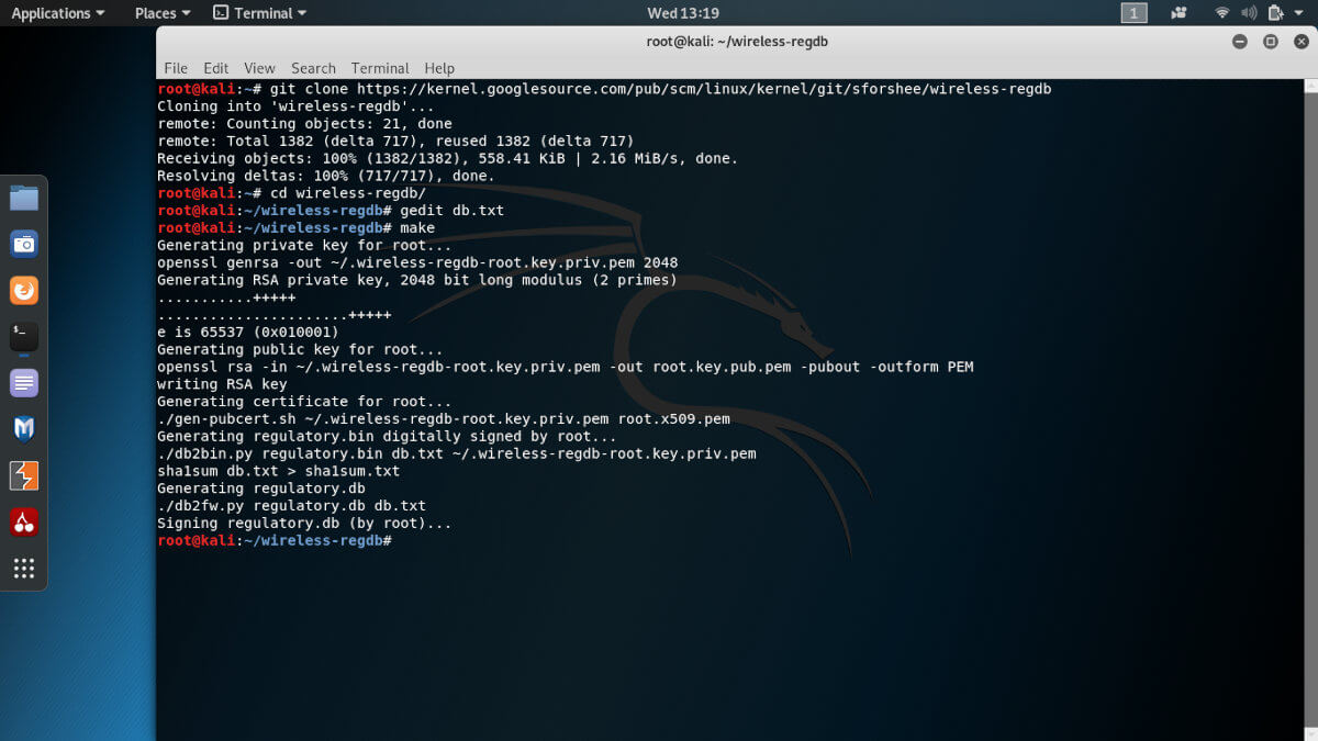

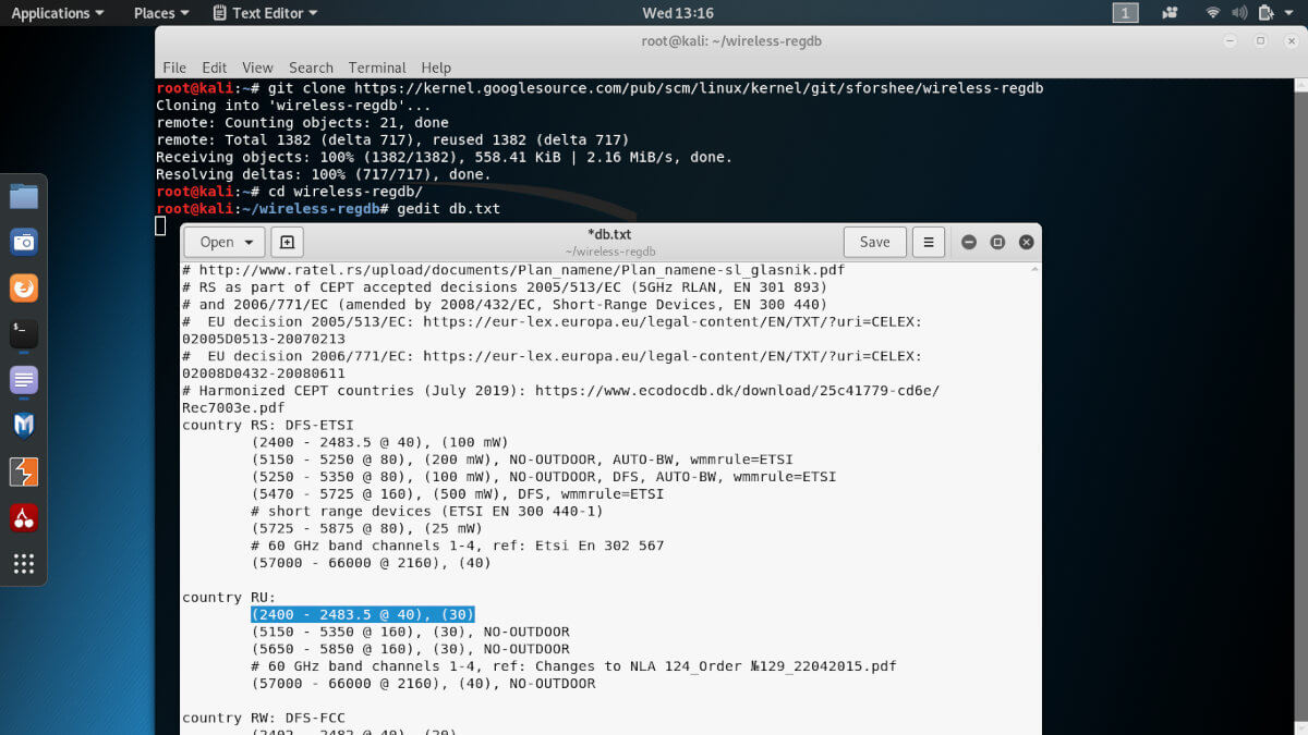

Method 2
It is used for those WiFi adapters that have the regional code in their own memory. For example, these are all Alfa Networks adapters that I have come across. They ignore global settings (including iw reg set BZ), so you will have to change the restrictions themselves for the country that is already recorded in the dongle's memory.
iw reg get # Find out for which country the adapter is released
git clone https://kernel.googlesource.com/pub/scm/linux/kernel/git/sforshee/wireless-regdb # Clone our WiFi regional restrictions database
cd wireless-regdb / # Go to this directory
gedit db.txt # Edit the source of the database
Changing the power limitation of WiFi transmitters in regional settings
We find the required country by code and instead of 20 (dBm) in brackets we write 30 everywhere (or even 33, that is, 2000 mW). We make similar changes for country 00 (yes, at least for all countries) and save db.txt.

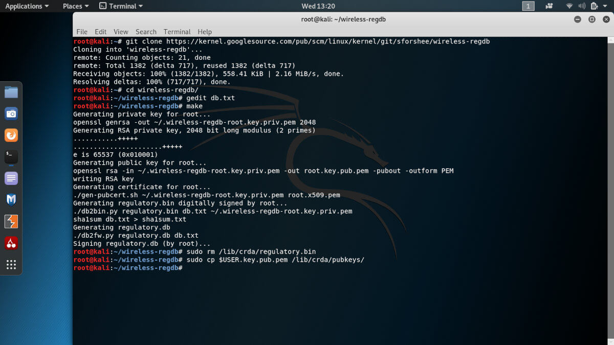

Previously, to compile a database from a text file and sign it, you had to install a Python wrapper for the OpenSSL library, but the new Kali version already has it (python3-m2crypto). Therefore, we simply write the make command and get a new regulatory.bin, where all restrictions are removed (more precisely, they are set deliberately large).
Build your base with more powerful WiFi permissions
Next, we delete the old (original) database, copy our (modified) database instead, copy our public key (since the database is digitally signed) and restart.
rm /lib/crda/regulatory.bin
cp regulatory.bin /lib/crda/regulatory.bin
cp $ USER.key.pub.pem / lib / crda / pubkeys /
reboot
Changing the power limit in regional settings
Everything! Now, after rebooting into Live USB Persistence, we expose the adapters to the increased power in the standard way.
ip link set wlan1 down # Turn off the dongle
iw dev wlan1 set txpower fixed 23 mBm # Double the power
ip link set wlan1 up # Enabled dongle
Checking the result:
iw reg get
It should be something like this (here a 10 dBm increase in power).

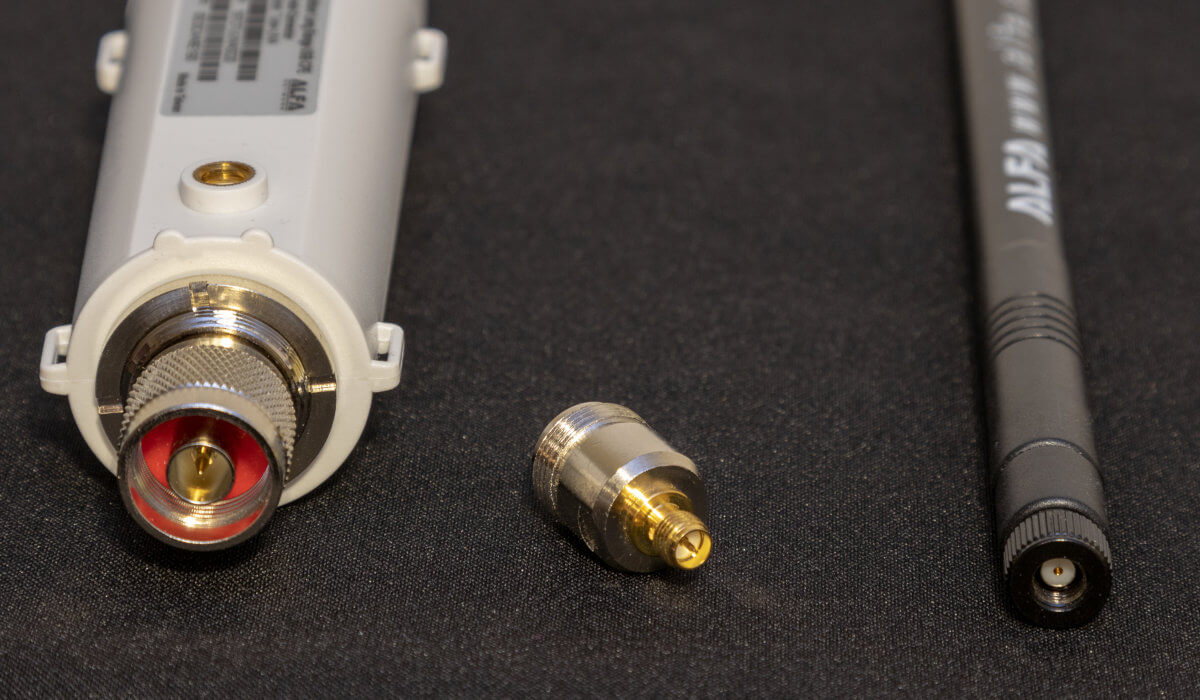

How to connect a custom antenna?
In practice, the antennas have to be changed, so it is worth choosing an adapter with a connector for connecting an external antenna. The problem is that they are different and do not fit together. Typically for indoor equipment, the miniature RP-SMA connector is used, and the more powerful "outdoor" adapters such as Alfa Tube-UNA have a large N-Type socket. Coaxial adapters help them make friends. Choose the highest quality possible, otherwise the signal-to-noise ratio (SNR) will deteriorate. The photo shows an N-Type to RP-SMA adapter. I used it to connect ARS-N19 and APA-M25 antennas to Alfa Tube-UNA with built-in signal amplifier.
Connecting RP-SMA Antenna to N-Type Adapter

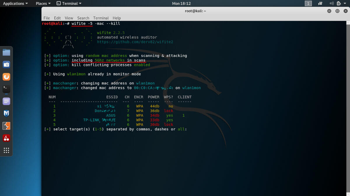

The entry threshold for learning to hack WiFi is constantly dropping. Over the past couple of years, a collection of simple and effective utilities has grown again to automate most types of wireless attacks. Once upon a time in Kali (then BackTrack) there were only raw scripts, but now your eyes run up from the abundance of ready-made tools.
Today, you don't even have to start by learning Aircrack-ng - the package on which almost all Wi-Fi hacking tools are based. The WiFi-autopwner scripts from Alexey Miloserdov and Wifite2 from Derv Merkler (the pseudonym of the Seattle programmer) will help you quickly get a practical result .

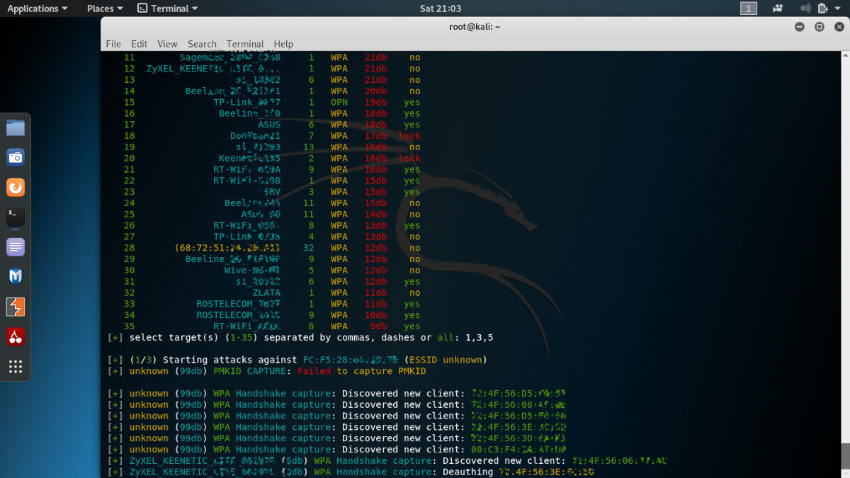

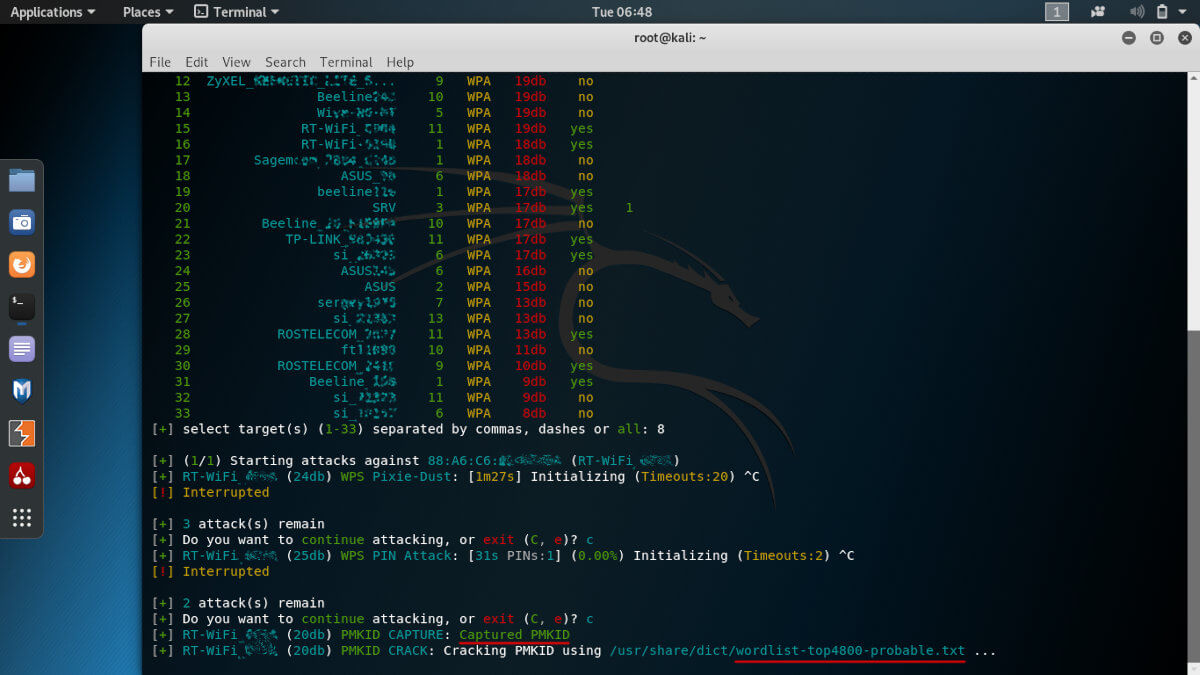

I like both scripts, but Wifite2 and its popular fork are more familiar. It intelligently uses additional utilities to improve audit efficiency and allows you to automatically execute the five most common types of attacks on all at once or only on specified access points.
Wifite2 uses bully, tshark and reaver to perform PixieDust or pin brute force attacks on WPS. It uses coWPAtty and pyrit to test the handshakes captured during the WPA (2) attack and implements a new PMKID attack using hashcat.
Successful capture of PMKID handshake
All types of attacks are already sorted by execution speed. First, the fastest (WPS, WEP, PMKID) are used for the selected access point, and in case of failure, the script proceeds to the next options. Moreover, when you turn on the verbose -vv mode, all the commands used and their result are displayed in the terminal. Essentially, this is a learning and debugging mode.

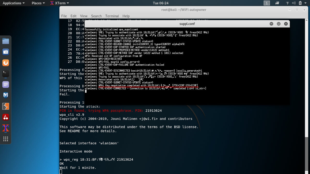

Before, I would answer: WPS. If Wi-Fi Protected Setup is enabled on the access point, then it is most likely that it is opened by brute-force attacks on known pins or a more elegant PixieDust attack. The list of pins to search for is taken from the manufacturer's default configs, which is determined by the MAC address. To do an exhaustive search of all options (brute force) is most often pointless, since after N unsuccessful attempts to authorize via WPS, the router blocks further ones for a long time.
Successful selection of WPS PIN using WiFi-Autopwner
In any case, the attack on the WPS took up to five minutes and seemed to be fast compared to waiting for the WPA handshake to be taken, which then had to be brutalized for a painfully long time. However, now a new type of attack has appeared - PMKID (Pairwise Master Key Identifier). On vulnerable routers, it allows you to capture a handshake in a matter of seconds, and even in the absence of clients connected to it! With it, you do not need to wait for anyone and deauthenticate, just one (even unsuccessful) authorization attempt on your part is enough.
Therefore, the optimal hacking (audit) algorithm is as follows: we determine whether the WPS mode is enabled on the target access point. If so, launch PixieDust. Unsuccessfully? Then the enumeration of known pins. Did not work out? We check if WEP encryption is enabled, which also bypasses the entry. If not, then we perform a PMKID attack on WPA (2). If it didn't work out that way, then we recall the classics and wait for the handshake (so as not to get fired) or actively kick clients in order to catch their authorization sessions.
I found out the WPS PIN, what's next?
Then you can use it to connect to the router and find out the password, no matter how long and complex it may be. In general, WPS is a huge security hole. On my equipment, I always turn it off, and then I also check with a WiFi scanner if WPS is really turned off.

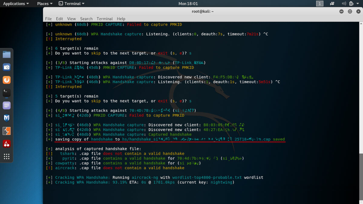

I intercepted a handshake. What to do with him?
The four-way handshake is written by the Wifite2 script to a file with the .cap extension.
Capturing classic WPA handshake
TCPdump, Wireshark, Nmap, and other programs use the .pcap format. The PMKID handshake will be in .16800 format.
By default, Wifite uses Aircrack-ng to guess passwords. He sends a command like
aircrack-ng yourhandshake.cap -w /yourwordlist.txt
In the simplest versions, this is enough, but more often you have to convert handshakes using hcxtools to feed one of the advanced password brute force utilities. For example, John the Ripper or hashcat.

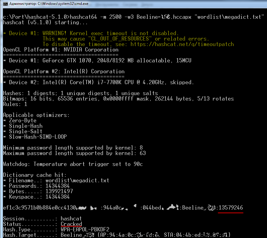

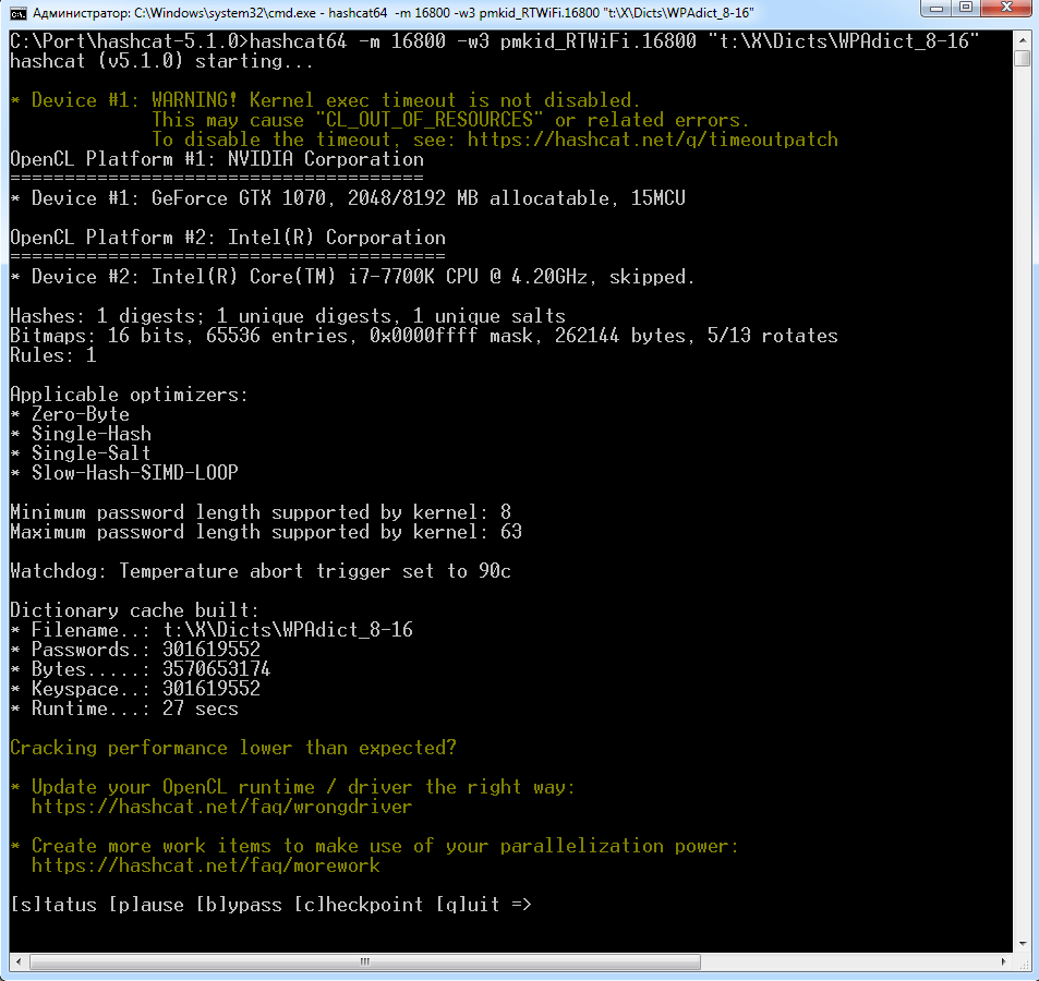

I like hashcat better. To work with it, you need to convert .cap to .hccapx format. You can also do this online or locally using the cap2hccapx utility. In the latter case, you will have to download the source and compile it.
wget https://raw.githubusercontent.com/hashcat/hashcat-utils/master/src/cap2hccapx.c
gcc -o cap2hccapx-converter cap2hccapx.c
It is more convenient to put the resulting executable file cap2hccapx-converter into / bin, so that you can then access it from anywhere.
mv cap2hccapx-converter /bin

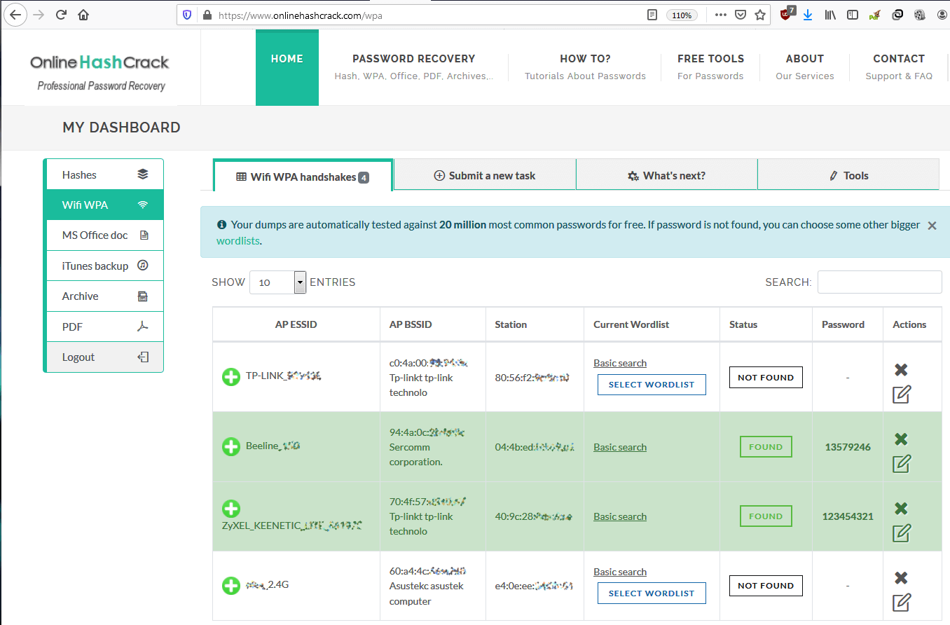

Successfully hacked WiFi password in hashcat using WPA2 handshake
PMKID hashes are baked in the same way. You just need to explicitly specify the handshake type and dictionary to hashcat.
hashcat64 -m 2500 -w3 Beeline.hccapx "wordlist \ wpadict.txt" # We iterate over passwords in our dictionary wpadict.txt to the hash from the WPA (2) handshake in the Beeline.hccapx file
hashcat64 -m 16800 -w 3 RT-WiFi.16800 "wordlist \ rockyou.txt" # We use the PMKID handshake from the RT-WiFi.16800 file and a ready-made dictionary rockyou.txt
Brutus PMKID in hashcat

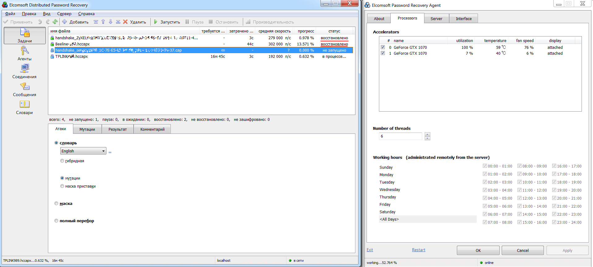

Another interesting option is to use a distributed computing network. This can be done, for example, by Elcomsoft Distributed Password Recovery. This versatile program understands dozens of password and hash formats, including .cap, .pcap, and .hccapx. Up to ten thousand computers can simultaneously work on one task in it, combining the resources of their processors and video cards.
Distributed brute WPA hashes

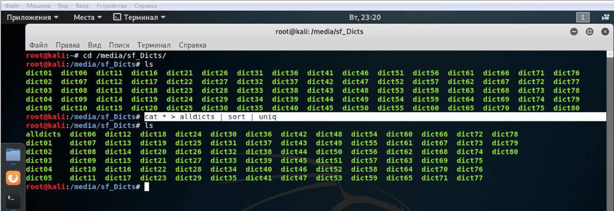

Plus she has a very advanced approach to dictionary attack. You can use masks, prefixes and mutations, in fact, expanding the volume of the dictionary several times.

How to compose your own dictionary?
I first put together a collection of dictionaries from various sources. These were pre-installed dictionaries in password brute-force programs, the / usr / share / worldlists / directory in Kali Linux itself, databases of real passwords leaked to the Network from various accounts and collections on specialized forums. I have brought them to a single format (encoding) using the recode utility. Then I renamed the dictionaries using the dict ## template, where ## is a two-digit counter. It turned out 80 dictionaries.
Combining 80 dictionaries by skipping identical entries
In the next step, I merged them into one, removing explicit duplicates, and then ran the PW-Inspector utility to clear the merged dictionary of garbage. Since WiFi password can be from 8 to 63 characters, I deleted all entries shorter than 8 and longer than 63 characters.
cat *> alldicts | sort | uniq
pw-inspector -i alldicts -m 8 -M 63> WPAMegaDict
Then I thought that the file was too large, which could be reduced further without clearly compromising the efficiency of the iteration. Have you seen Wi-Fi passwords longer than 16 characters in real life? So I have not seen.
pw-inspector -i WPAMegaDict -m 8 -M 16> WPADict_8-16
The resulting dictionary can be downloaded from Kim Dotcom's file hosting service (647 MB in ZIP-archive, 2.8 GB in unpacked form).
How do I switch to the 5 GHz band?
First, you need to connect a Wi-Fi adapter with 5 GHz support and equip it with a suitable antenna (they are also made for different bands). Then just start Wifite with the -5 key, and you will see 5 GHz access points. They are usually much less than 2.4 GHz. This is due to both their relatively small distribution and shorter range. The higher the frequency, the (other things being equal) the faster the signal decays.
Enabling 5 GHz Mode in Wifite
Can a hidden network be attacked?
Yes. If the network name (ESSID) is hidden, you can see the MAC address of the access point in the same way when scanning the air. The first client to connect will reveal her name. Therefore, just wait for the connection or speed up the process by sending out deauthentication packets.
Finding the name of a hidden WiFi network
