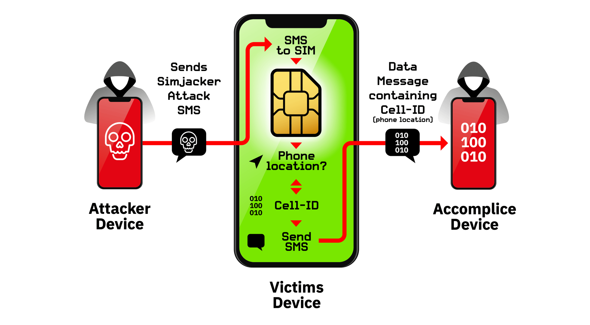

The working scheme of the Simjacker attack is based on sending a simple SMS message to the victim. In the sent message, the hackers insert malicious code, which is similar to spyware. This scheme is not standard, because in the main case the link is sent in the form of an SMS to some malicious website and not the malicious code itself. Simjacker is the first real attack in which spyware is sent directly to an SMS message.
Malicious code gives the SIM card the command to "conquer" the phone and prepares it to execute various commands. All processes are carried out without the participation of the victim and he / she has no information about the notification and the processes caused. Incoming messages are not stored in the phone memory, and all commands and processes are executed in hidden mode.
After a small modification of the malicious code, the hacker can gain access not only to the location of the victim, but also make calls, send short USSD messages, hang up the SIM card, and run some single applications.

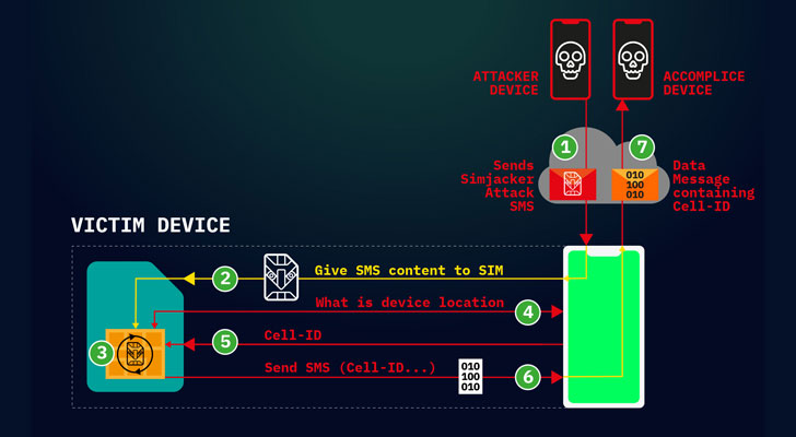

S@T Browser, short for SIMalliance Toolbox Browser, is an application that comes installed on a variety of SIM cards, including eSIM, as part of SIM Tool Kit (STK) and has been designed to let mobile carriers provide some basic services, subscriptions, and value-added services over-the-air to their customers.
Since S@T Browser contains a series of STK instructions—such as send short message, setup call, launch browser, provide local data, run at command, and send data—that can be triggered just by sending an SMS to a device, the software offers an execution environment to run malicious commands on mobile phones as well.
How Does Simjacker Vulnerability Work?​
Disclosed by researchers at AdaptiveMobile Security in new research published today, the vulnerability can be exploited using a $10 GSM modem to perform several tasks, listed below, on a targeted device just by sending an SMS containing a specific type of spyware-like code.

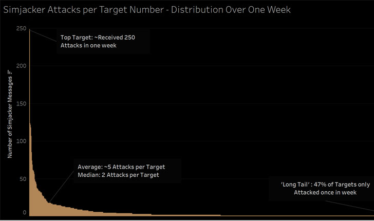

"During the attack, the user is completely unaware that they received the attack, that information was retrieved, and that it was successfully exfiltrated," researchers explain.
"The location information of thousands of devices was obtained over time without the knowledge or consent of the targeted mobile phone users. However the Simjacker attack can, and has been extended further to perform additional types of attacks."
"This attack is also unique, in that the Simjacker Attack Message could logically be classified as carrying a complete malware payload, specifically spyware. This is because it contains a list of instructions that the SIM card is to execute."
