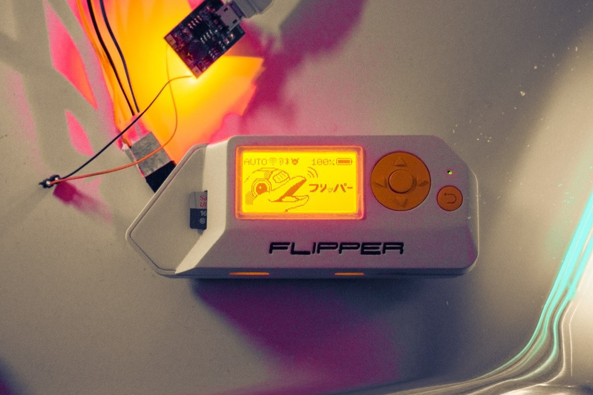

This is how Flipper Zero was born.
Flipper Zero​
The first device that Pavel Zhovner and his team will present to the world will be the Flipper Zero - a version of Flipper on a microcontroller. The variant with a full-fledged computer and Wi-Fi module will be called Flipper One, and so far it is only in the plans.
